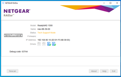

Hello Everyone
my department got an Readynas 1500 which is not working properly
and i tried many ways to fix it but still cant get access to it
the problem is
it will only get IP address on TECH Support and Formatting mode
On normal mode it doesn't get IP add and Raidar can't locate it

      I Did exactly as you said and You are right
      it report diskless now
      But now
      When i am trying to setup the hard disk (1 Blank as you said ) it say installing and after a few minutes it will disappear i don't know how much it needs to be formatted , waited for 2 hours nothing happened
