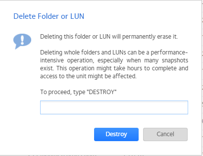

  • JJ53 wrote:
    but I now realise in the ReadyNAS OS removing a share isn't like removing a share in windows,
    Assuming you used the admin Web UI: You deleted the share, you didn't "remove" it.
    With an OS-6 NAS like the RN214, you would have seen this pop-up, and then entered "DESTROY" as instructed.
    As the pop-up warns, the share was permanently deleted.
    You could immediately shut down the NAS, and then attempt to use RAID recovery software in a PC (for instance ReclaiMe) to try to recover the data.  You'd need to connect the disks to the PC using either SATA or USB adapters/docks.  You could also reach out to Netgear paid support, asking for their data recovery service.  https://kb.netgear.com/69/ReadyNAS-Data-Recovery-Diagnostics-Scope-of-Service
    Either way, if you plan on recovery you either need to shut down the NAS altogether, or boot it up in read-only mode.  Any writes to the data volume will reduce the odds of recovering anything - and that includes system-level activity from apps, snapshots, etc.

  • StephenB's avatar
    StephenB

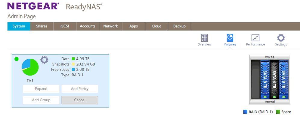

    • Sandshark's avatar
      Sandshark
      Sensei
      It takes a while for BTRFS to re-claim space, so that may be all you are seeing.
      If it doesn't get re-claimed, there is a chance at least some of your data is "trapped" in a snapshot that was not properly deleted.  Others have seen that when they intended it to be deleted.  How comfortable are you with the Linux shell via SSH?
      • JJ53's avatar
        JJ53
        I have never used linux before however I have an IT guy at work who would know, I could ask him to look at it if there is something more I can do.
        As you can see from the above screenshot, I have 2x 8TB in RAID, and it shows almsot 5TB of data still...

      • StephenB's avatar
        StephenB
        JJ53 wrote:
        I have tired recovery software on it and it just gives me a bunch on nameless files.
        What software package did you try?
        If you want to keep the option of data recovery open, you should pull one of the 8 TB disks.  That would prevent anything from being written to it.  Since you are using RAID-1 mirroring, you'd still have access to your files.  Later on, when you reinsert it the system will need to resync the RAID array.
        Then if the IT guy wants to help, he can mount the pulled disk in another linux system.  You should make sure he knows the file system is btrfs.
