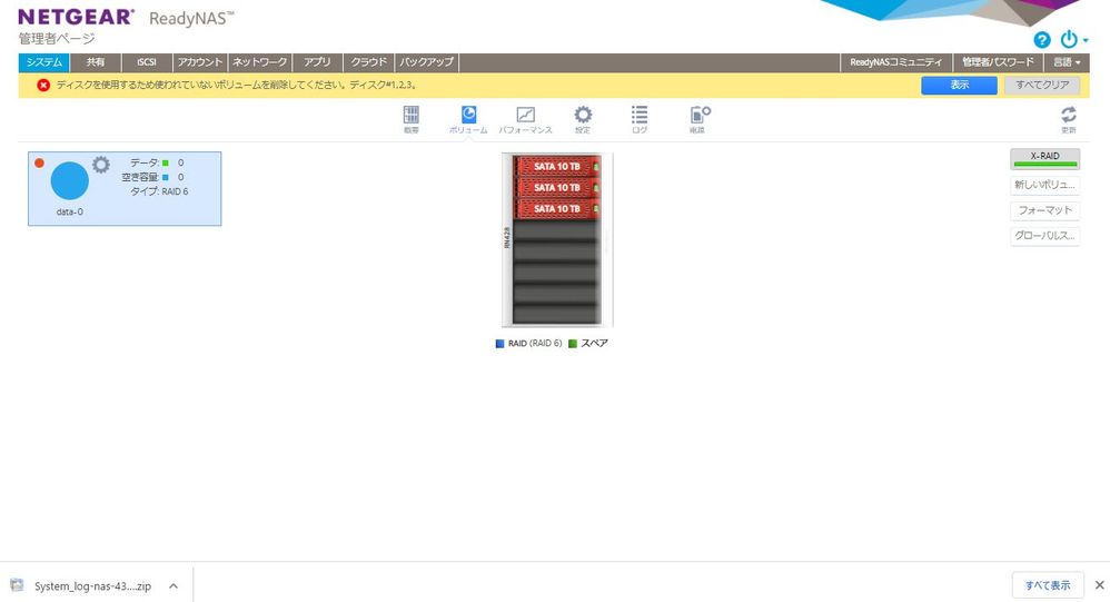

ReadyNAS 428: Error in recognizing 5 out of 8 HDDs with RAID6
I was building RAID6 with 8 * 10TB HDDs, but when I checked it, only 3 were recognized as shown in the attached figure, and the other disks were not recognized.
dmesg log
sd 4:0:0:0: [sda] 19532873728 512-byte logical blocks: (10.0 TB/9.10 TiB)
sd 5:0:0:0: [sdb] 19532873728 512-byte logical blocks: (10.0 TB/9.10 TiB)
sd 6:0:0:0: [sdc] 19532873728 512-byte logical blocks: (10.0 TB/9.10 TiB)
It is unlikely that 5 HDDs will be damaged at one time, so I think problem is occur on the chassis side. Os there any case of recovery from such a situation ?
Would you please teach me ideas of how to recover ?
A simple reboot didn't change the situation.
    Do you have data to recover?  Or is the issue just that the initial install failed to build the RAID array?
    Could well be.  If you are the original purchaser, the NAS should still be covered by Netgear's 5-year warranty.  You could go into my.netgear.com and request a warranty replacement.
    However, I would first test the 5 disks with vendor tools (WD's Dashboard or Seagate's Seatools).  If this were all shipped together, then they might have been damaged in shipment.

        ishi wrote:
        Unfortunately, this ReadyNAS is old and maker 3-year warranty is already expired.
        The warranty for the RN428 should be 5 years.  The product was launched in May 2017.  So I am suprised that they aren't replacing it.  Are you the original purchaser (and if so, did you purchase from an authorized reseller)? Perhaps Marc_V or JeraldM can follow up on the warranty aspect.
        ishi wrote:
        Do you mean it seems difficult to recover data in this situation ?
        It generally is difficult to recover data.  I don't think we know how difficult - it depends on what caused the problem.
        If you had data on the volume, then I agree it seems unlikely that 5 disks would suddenly become undetectable.
        If you can't find a replacement chassis (RN428, RN528, RN628, or perhaps an RR3312 rackmount), then you'll need a way to connect the disks to a Windows or Linux PC.  An 8-bay USB chassis is one way you can do that.
        From there you can attempt to mount the RAID array.  mdadm and btrfs are needed - they are normally linux tools, but there are open-source beta-level software packages for Windows available on github.  Another option for extracting data is to use RAID recovery software that supports BTRFS.  ReclaiMe is one package that several folks here have used with success.
