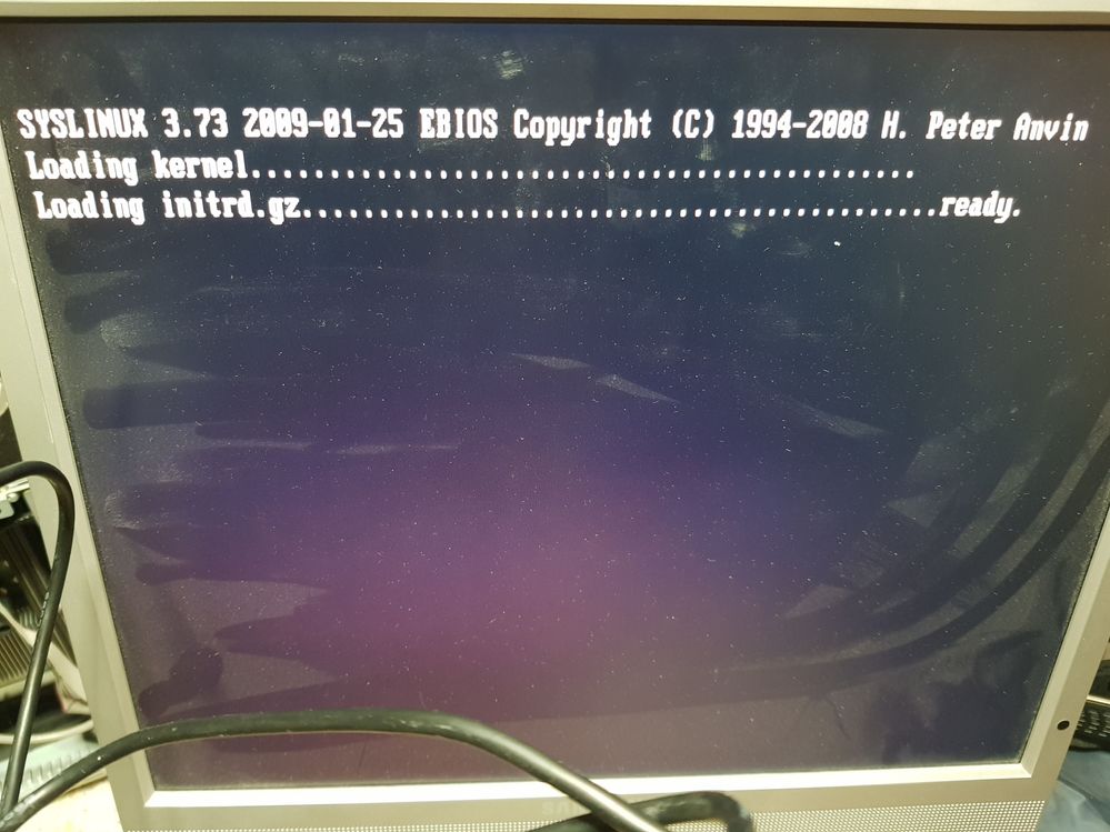

I would like to downgrade it to 4.2.x to flash the latest Bios. I know it would be possible to run flashrom directly in OS6 (tough some users said flashrom is missing some libraries after 6.3.3) but it bothers me I never could succesfully run USB recovery on any of my units (also on the SPARC based ones) and want to get to the bottom of it.
I connected a VGA header to the Pro 6 so that I can watch the boot process. Also removed all drives from it.
Prepared several USB sticks using the instructions for USB Recovery 4.2 and keep pressing the backup button with the stick plugged in fron USB slot.
One issue I encountered with the instructions to prepare the stick is that they said to unzip the 4.2.31 firmware in the same directory where the usbrecovery is located (both the firmware itself and the .html file is specified). If I do that, the usbrecovery after selecting in the pull down menu the destination drive letter it will select as image the .html file instead of the actual firmware (and cannot select anything else). I had to remove thus from the folder the .html file and only leave the firmware.
When I boot from it I get the screen below with the last line "Loading initrd.gz......ready" and then does nothing. Waited a long time.
It does not respond to any button and on the oled display just stays "ReadyNAS" (instructions say the units with a display will show a firmware upgrade in progress).
If I reboot the Pro will just boot into OS 6.
What am I doing wrong ?
    When you run usbrecovery.exe be sure to run that as an Administrator (right-click on the exe and select Run as Administrator). Not all USB keys are compatible. There are alternative utilities to make syslinux bootable USB keys such as Rufus that you could also try.
    If booting off the USB works properly the system should do the USB Boot Recovery and shutdown.
    Note that the EEPROM may become corrupt as a result of doing USB Boot Recovery. If this happens instead of the model number it'll show up in RAIDar as "To be filled by O.E.M." (or something like that).
    You don't need to use USB Boot Recovery to downgrade. There is a RAIDiator-x86-4.2.31-downgrade image which can be used to downgrade back to RAIDiator-x86 4.2.31 through the web admin interface of OS6. The downgrade image tricks OS6 into thinking that its an OS6 firmware image. I think unlike USB Boot Recovery this method requires a disk to be installed to do the downgrade. Also a manual factory reset (wipes all data, settings, everything) would be needed to wipe the OS6 install off the disks.
    • Thank you for suggestions. I used Run as Administrator when I ran usbrecovery.exe. I am aware the system is picky regarding the boot stick and prepared 3 sticks, the old 1GB Imation works to boot (and get to the status shown in the attached foto). The other 2 sticks, both 16GB (a Sandisk Cruzer and a no-name) would not boot (I get a message "media is not bootable" when I start Pro6 with them plugged in front USB). In the past I was using Rufus or rawwrite to create bootable sticks but I am not sure how to put together the syslinux image and the fimware so that the system is not only booting but also proceeds to write the content of the Raidiator 4.2.31 to the internal flash, if I remember correctly in both Rufus and rawwrite I had an .iso file that was selected as input and writtent to usb stick.

        Did you make sure to use the MBR partitioning scheme and e.g. the FAT32 filesystem? Note that the USB key needs to have a partition table with a single partition. The boot recovery files need to be on that partition. Another common mistake is not to have any partition table or partition which will mean that when the boot recovery script looks for that partition it won't be able to find it.
