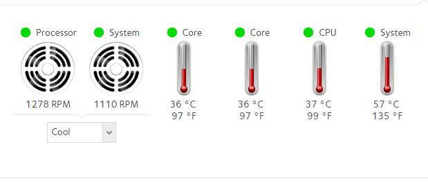

I've been following some of the CPU upgrade articles on this forum and pulled the trigger on upgrading my Pro BE to Intel Xeon x3230.  Also upgraded OS4 to OS6.9.3 - Thanks to all of the talented people in this community I was able to follow some of the instructions and tips to successfully upgraded my CPU. However I have the following questions....
1. In OS 6.9.3, It seems like it only detected 2 cores instead of the quad cores.  I have attached a picture.  The log did not show any errors.  Can someone confirm this is what I supposed to see on a quadcore?
2. I like to upgrade the system and cpu fans to keep things a bit cooler.  Any recommandations?
  • OK, that's a configuration file issue, then.  Your screen dumps didn't show up when I first replied, and I didn't realize you were using the core temperatures to determine you only have two.  Check dmesg.log and see if you see a line continaing x86: Booted up 1 node, 4 CPUs.  If so, it's seeing a 4-core CPU.  The command lscpu can show you even more.
    The configuration you need to modify is /etc/sensors.d/system.conf, which by default on a Pro6 should be a pointer to /etc/frontview/sensors/NV6.conf.  Restoring the link or just copying the NV6.conf to /etc/sensors.d/system.conf should fix the voltage issues, but I don't know about the CPU core issues since I don't have a Pro6 with a quad-core CPU.  The configuration for my 4-core Xeon based 4200s actually ignore all core temperatures and set the CPU temperature in the lower section of the file to "temp2".
