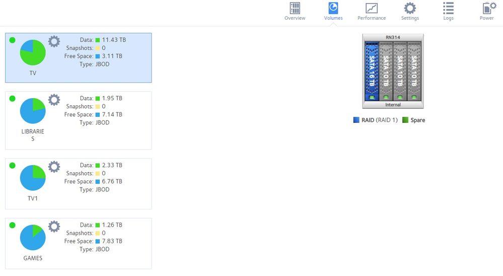

      Not sure why it shows RAID1 on the first disk and JOBD type. Is this a correct setup for single disk use? (image attached)

        From the screenshot, it looks like you have 4 JBOD volumes, one for each drive.
        claynz wrote:
        So destroy the volume, replace the drive, format the replacement, re-create the volume and doing this wont effect the other drives?
        Yes, that's the process.  The other drives aren't affected.  You will need to recreate shares, and any backup jobs that use them.  Then restore data.
        If you have apps installed:  One of the volumes is hosting the /apps folder.  If that's the volume you are upgrading, then uninstall the apps before destroying the volume, and reinstall them afterwards.  (/apps will end up being hosted on a different volume).
