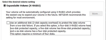

      - I checked both options: X-RAID2 and also the sub option (use an additional disk) (image 1)

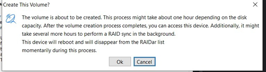

      - Then it showed me that the volume is about to be created (image 2)
      After a few seconds it did nothing, so I checked the NAS and I saw the following error: RAID creation failed (image 3).
      Maybe I could do the factory reset again but this time without the sub option: use an additional disk.
