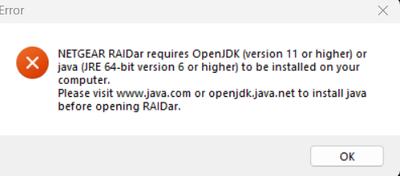

I've done some reading here in regard to similar issues but it all seems very complicated, and further the RAIDar software often mentioned will not install on my Windows laptop as it can't find Java even though I have Java 17 installed.
Try this JRE

I can obtain various JRE versions, but note RAIDar states it needs at least JRE 11 - hence I expected 17 to be fine.
Netgear hasn't maintained RAIDar. The JRE I posted works with RAIDar 6.5 (and everything newer I've located will not).

Okay I will try with JRE 8. This is the error I got from RAIDar - and it is a bit confusing as it states OpenJDK 11 or later, but then 64-bit JRE 6 or later (which really makes no sense - I'm a Java VM developer - as you can't require something from 11 but still run on 6.

RAIDar won't run. It flashes up blank command window which then disappears and nothing happens.
