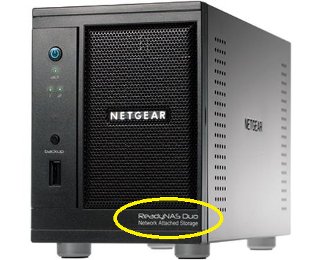

  • Let's start by determining if you really have a Duo V2, because AFAIK, all the LEDs on a V2 are blue.  Does it say "Duo V2" on the front panel?  If it does not, regardless of what may be on one of the stickers on the unit, it's a V1.
    It sounds like you are in the boot menu and it's waiting for you to make a selection via the backup button.  But you need to be sure which unit type you have, because the instructions are a bit different for each.

      • StephenB's avatar
        StephenB
        corkscrew22 wrote:
        To answer your question re model there is no ID on the front
        There is.  Sandshark is talking about this:
        The circled part says "ReadyNAS Duo" on the original v1, but it says "ReadyNAS Duo v2" on the v2 model.  However, we can also tell from the firmware - The v1 runs 4.1.x, and the v2 runs 5.3.x.  So you have the original Duo (called a v1 here). The "v2" label on the back means it is "hardware revision v2 of the Duo v1".  Very confusing branding on Netgear's part, and I'm sure support has been very unhappy about that for a very long time.

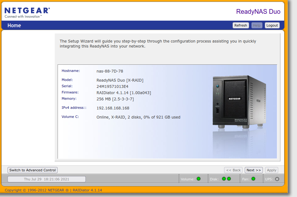

        If you did a factory default (and it sounds like you did), then the disk space isn't used, and the data is gone. The disks are formatted as part of the process. There is some space usage that shows up in Frontview, but that isn't real - it's reserved by the NAS.  If I recall correctly, it will show about 20 GB of used space after setup completes.  Your setup screen is showing 0% used.
      • Sandshark's avatar
        Sandshark
        Sensei
        That is a Duo V1.  Netgear originally used a "v1" or "v2" on the stickers to indicate minor board version differences on the Duo and NV+.  They then created an entirely different line and re-used the "V2" designation -- creating a lot of confusion.  The "real" V2 hardware and OS are entirely different from the V1, and they are in no way interchangeable.
        So, you have likely been following the wrong instructions for using your NAS.  But the screen grab you posted is of what appears to be a completely healthy Duo V1 with a volume just created.  Did you re-install the firmware (which retains the volume), or do a factory reset (which wipes the drives)?
