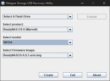

 The unit only says 'booting' and doesnt' nothing else with or without drives.
 Trying to flash it. I downloaded both 'ReadyNASOS-6.9.3-x86_64.img' an...
mdgm-ntgr
Aug 13, 2018NETGEAR Employee Retired
The RN104 is an ARM unit. It can't run the x86 firmware. Similarly the x86 models can't run the ARM firmware.
Some USB keys are incompatible.
