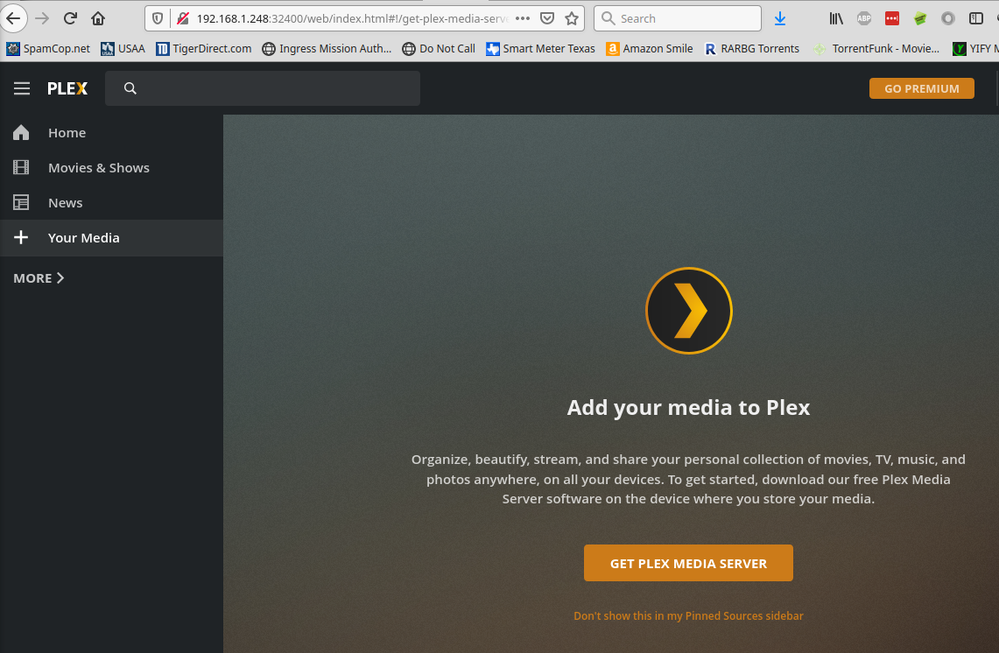

        However now I have the same problem as a similar poster. Even though I am launching the app from my server, it refuses to find the server itself as an available server. Clicking on
        + You Media
        takes me to the software download page.

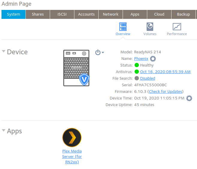

        This is the admin page on my NAS

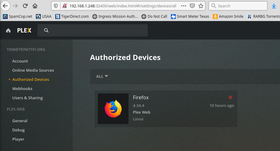

        This is what I get when I launch the server. 192.168.1.248 is the IP address of my NAS. The Firefox device shown appears to be from my NAS. I haven't accesst Plex from anything else. Note that it wants me to get the server software.
