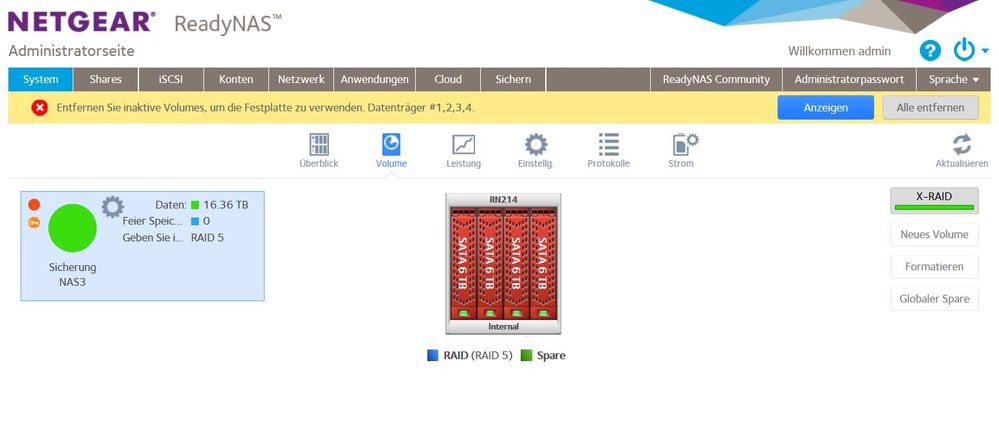

Hi Forum Members,
I need your help.
yesterday I updated 2 of my 3 RN214 NAS to  the new firmware 6.9.2. and the one I had a RAID volume on it, cant build its volume no longer. I got 4 RED drives in die GUI now. the volume is gone. I tried rebooting and also went back to firmware 6.9.1 with no effect. the boot time seems also very slow. until I have access to the GUI it takes around 7minutes.
The drives seem all fine
the root isnt full
I cant find any btrfs failurs,
but about here ends my knowledge after reading thru the forum posts
I have a full log download, would love to send it to a specialist here.
the name "mdgm" keeps coming up, should I PM the log there?
Thanks guys!

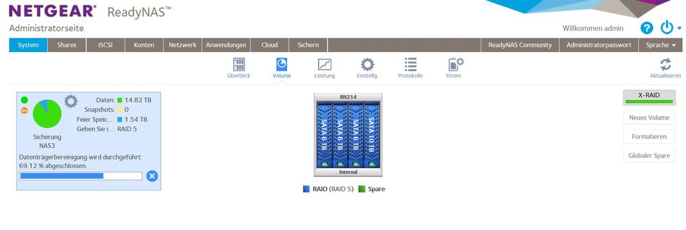

    • bastelspezi's avatar
      bastelspezi
      yes of course. meanwhile I removed one of the harddrives just to see what would happen and it mounted the volume again. but obviously degraded. i backuped a few things off of it. and later installed a new harddrive in slot 4. then it resynced. it said it was successful, but the volume is messed up. I got now a lot of btrfs errors in the log files. it says the snapshots use 0GB of space but they are all there. but I cant delete them from the GUI. I think because the volume is apparently in read only. I also cant write onto it. I'm doing a scrub right now but i think thats making it all worse.
      I have log files of every stage of the progress now.
      I would really like to know how this all happend in the first place.
