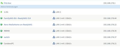

I have the following network set-up at home on my Fritzbox Router 4590:
I recently added a second RN314 as back-up-NAS to the network named "FamilyNAS-BU". My first NAS was named "FamilyNAS" but is now named "Nero-MediaHome-on-ReadyNAS" which is not clear to me why the name changed (on the admin page the name remaines "FamilyNAS")?

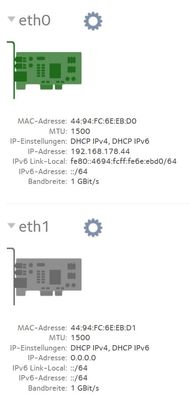

FamilyNAS Network information on the admin page
see attached photo...

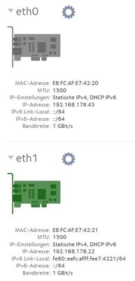

FamilNAS-BU Network information on the admin page

    Did you mean the Fritz box 5490??
    Do you have the Nero Mediahome app installed on the NAS?  Assuming you do, try turning it off and then reboot the NAS.  I think if you do that, the Nero Mediahome name will disappear from the router.  I think the router is seeing the DLNA server name.  Note this is a test - after you check this you can turn the app back on.    Though I am wondering why you aren't using the built-in DLNA server (just out of curiousity).
    But I don't think you'll see FamilyNAS on the router when you do this test - because you've assigned it a static IP address.  If you change the NAS configuration to use DHCP, you can use IP reservation in the router to make sure the router always assigns it the same address.  With the Fritz router, this is the setting to "always assign this network device the same address".  At least that is what it is called in the 5490 manual.

  • Dear Stephen,
    thanks for your helpful reply. I removed the NERO application complete as I in fact do not use it. Furthermore I switched to DHCP which resultes in an address change in the Fritzbox. I manually restored the old address and now I see the FamilyNAs in the Win10 Network folder again.
