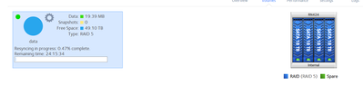

        RN424, Installed 4 new 18TB drives:
        - LCD display displayed "Booting" followed by "Factory Reset...", then "Configuring Network", then it completed booting
        - LCD shows "Resync data  0.4%"  and it's crawling along
        On login (admin/password), the wizard automatically appeared and walked me through initial setup. Perfect.
        In the System/Volumes tab, I can see the resyncing taking place, says it will take another 24 hours??
        There's no data copied onto these drives yet, so what is the NAS "resyncing"? Nomenclature is confusing.
