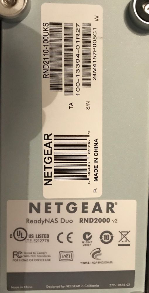

I picked up this readynas duo from a friend who owed me some money.
I was going to drop it on ebay after testing it but I have had nothing but issues with it.
I dropped a drive in it and waited for a bit, it loaded the os itself (i think)
After a while I hit the web interface and clicked a few buttons to get the system up and running.
I then checked the firmware and done a update to : 4.1.16
I then upgraded the ram from 256mb to 512mb as I had a stick laying about.
I tried to access a shared folder and just could not get in, after some digging about I found it was windows 10 blocking access as the readynas duo was only running smb 1.
I checked for updates using the build in update checker to find no updates, so I hit the netgear website and downloaded an upgate v5.3.13 but it keep failing to install, I tried in chrome and IE.
I also tried to load 6.9.2 with no luck.
I am feeling like the box is a V1 and not V2 as the sticker on the bottom states.
Any help on this would be great.

    It is a Duo v1 that uses a sparc processor.  More pedantically, it is hardware revision 2 of the Duo v1.
    The labeling is confusing - Netgear should have branded the Duo v2 differently.
    A Duo v2 would have a v2 label on front  and the part number would end with -200UKS.
