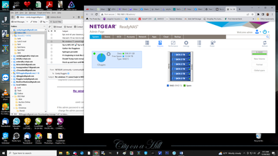

windows 11 cannot login to NAS 316
I cannot login to NAS from windows 11 or map a drive. I can ping the NAS from command prompt in window. Can login to NAS from browser. Have checked settings and don't know where to start again. ...

- cdugginsDec 29, 2022Guide
used correct IP and haven't changed password
I think I am used x-raid from the description I found on it...but maybe not.
I recently added larger drives and each drive I had to format then the NAS did it's thing in backing the data up to the new disk.
Where or how can I know if I am using X-RAID?
also I followed all the error 67 fixes and none worked.

If there is a green stripe on the X-RAID control on the volume tab of the NAS web ui, then you are using X-RAID.
If you are using X-RAID, then the volume name is Data. If you are using FlexRaid, then the volume name is likely different - and you'd need to modify the command above to use the real volume name instead of \Data.
- cdugginsDec 30, 2022Guide
when we set my NAS up originally somehow we did change the sharename from DATA to cduggins and I've used that in the net use command.
I haven't changed the password. and still cannot map a drive; getting same error 67
