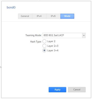

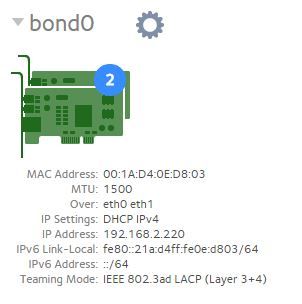

Bond on ReadyNASBonding/teaming is setup on the NAS as a LACP team connected to a Netgear JGS524PE - 24-Port Gigabit ProSAFE Plus Switch through ports 13 and 15. The LAG was disabled on the switch and is now enabled. Switch has firmware 2.0.1.40. I am now going to try with the bond removed and use a single ethernet port on the switch (not 13 nor 15).
Bond on ReadyNASOn Netgear switch
