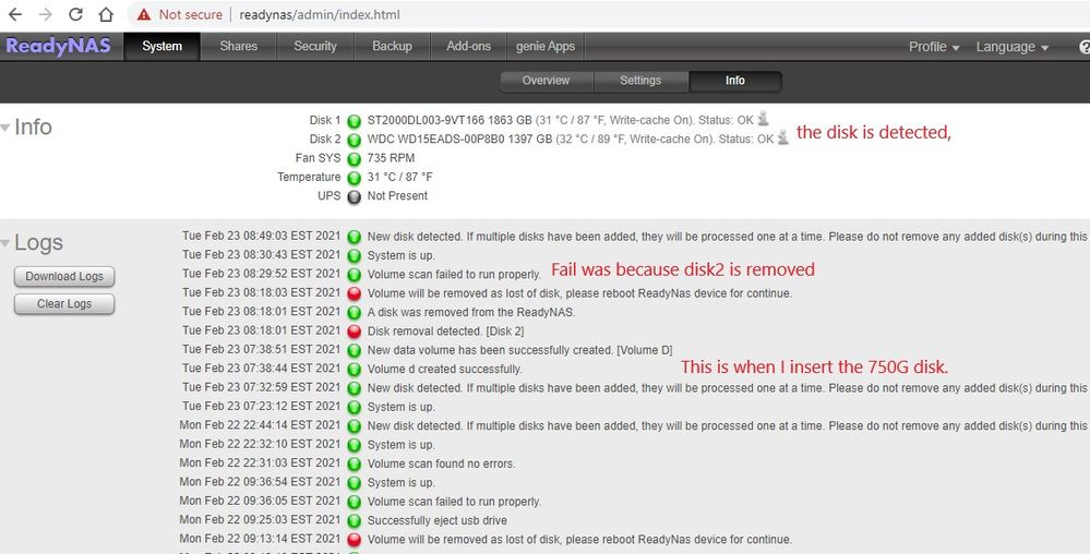

I have been trying all the different ways but had no luck. However, I do believe what you said is correct, as it simply worked on my another disk, here is what I have.
Disk1 - 2000GB (has important data)
Disk2 - was 750GB, I wanted to switch it to 1500GB. the 750BG one had data on it, after a few times back and forth switching, the data got erased, but at least it still shows up on the volume. The 1500GB one had data on it too, could be accessed by Windows, and I remember I used it on ReadyNas as well, I was simply switching the disks on Disk2 and used both before, then Windows might have changed the partition table in order to read it.
I have tried 1) delete the volume from windows then insert to ReadyNas, 2) fsck on ReadyNas via SSH, then remove/reinsert to ReadyNas, 3) vi /etc/fstab, removed the line for the disk2, then reinsert the disk. For the 750 one, ReadyNas automatically added it to the volume and showed the correct size, but for the 1500 one, it only shows up info, and the status is OK, but won't be added to the volume.
I’m thinking to reset ReadyNas to factory default, but I’m afraid this will erase the data on Disk1. Do you have any other suggestions?
Thank you again for your help!
- StephenBFeb 23, 2021Guru - Experienced User
"added to the volume"???
Are you trying to do this with XRAID? If you want the disks to be independent you need to use FlexRaid - creating a second volume (D on the second disk).
