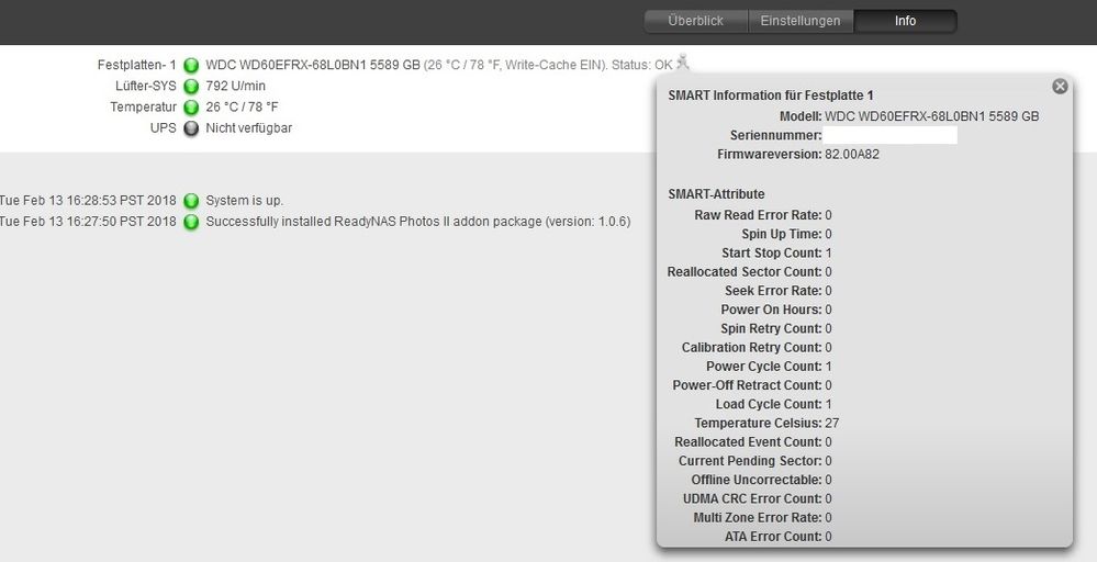

tested HDD WD60EFRX in ReadyNAS Duo V2 (arm) working
WD60EFRX-68L0BN1 firmware 82.00A82
RAIDiator 5.3.13

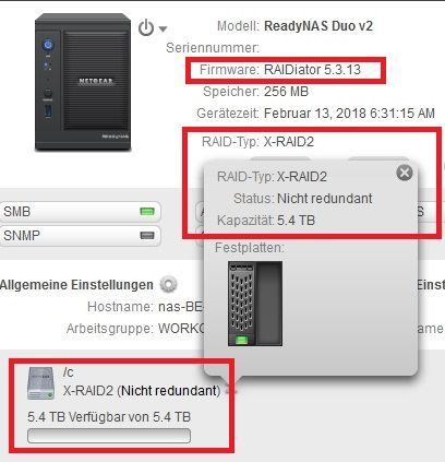

HDD in X-Raid2 formatted, transfer rates with large (several 100MB) files 35-40 MB/sec in gigabit network

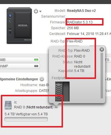

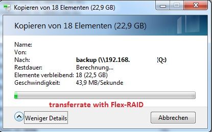

HDD in Flex-RAID formatted, transfer rates with large (several 100MB) files over 40MB/s in gigabit network

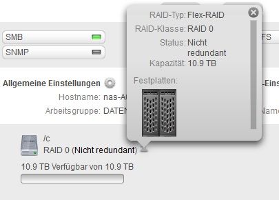

  • Now I added a second WD60EFRX to the first one and had to see disappointed that the firmware will do the following if you make a factory reset via paper clip and pushing twice the backup button and using the paper clip again:
    - if you select X-RAID2: it will create a Raid1 in X-RAID2 over both physical drives (which is according to the manual)
    - if you select Flex-RAID and then Raid0 or JBOD: it will always create a Raid1 in Flex-RAID over both physical drives (which is not according to the manual)
    But I would like to use the full 12 TB (2x 6TB) in one logical volume for data because I have another NAS for backing up the data. So I need no mirroring. Is there another possibility to force the device to do this? Via console?

    • konsum69's avatar
      konsum69
      The configuration in the last post was done with Raidar 6.3.0. I think this version is faulty!
      Because with the old version of Raidar 4.3.8 the configuration was good: selected Flex-RAID with Raid0 and now one logical volume over 10,9 TB with two physical WD60EFRX!
      • StephenB's avatar
        StephenB
        Yes, you need to use RAIDar 4.3.8 to enable FlexRAID on a legacy NAS.
