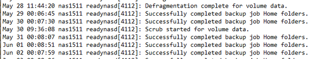

      Thank you StephenB.  I found the scrub started event in the readynasd log.  Apparently this log rolls over relatively often as it does not go back to the last time I ran the scrub.

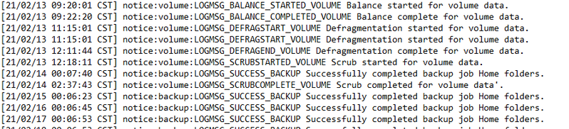

      I also found the scrub start event in the status log.  This time I only see the scrub start that looks like what i see in the readynad log.  The snip below is from the status log showing another scrub and you can see the scrub start and then the scrub complete events.
      The volume log shows the scrub event but does not say pass like it did previous times and like you showed below and has the exact same time as the start event from the readynasd log.

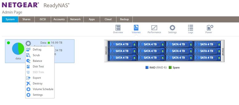

      I seem to remember that previously if a scrub or a defrag or a balance is running it shows when I go to the Volume settings but no scrub is showing now for me.
      Do you think it would be safe to click the scrub button again?   I would think if it were still scrubbing, I would get a "you can't do that now" message.  Thanks for any thoughts or suggestions.
