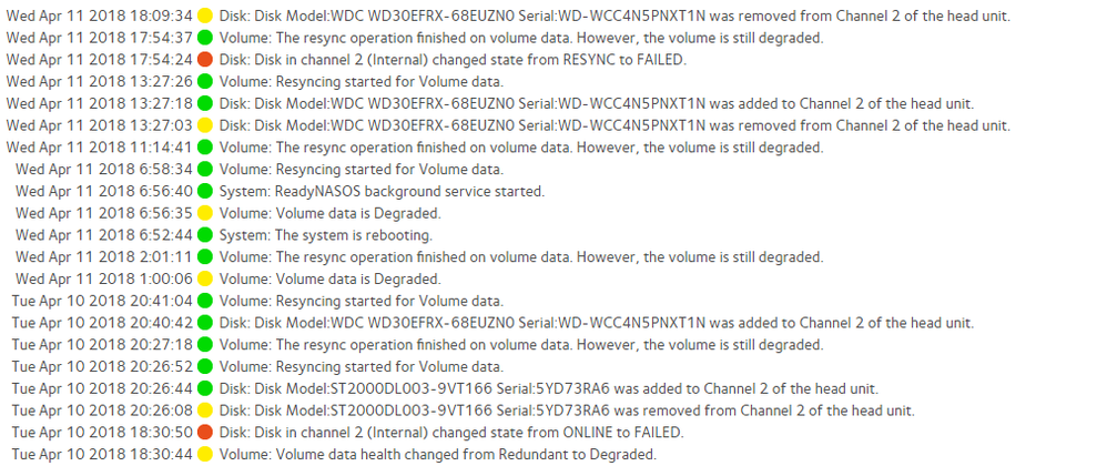

 After about 5 hours, the resync operation completed, but the nas compained about the volume still being degraded.
I did a reboot, the NAS repeated the process, and the exact same thing happened after 5 hours.
I hot-swapped (pulled and re-installed) the drive, and it started over again.
At 17:54:24 today the drive failed, and at 17:54:37 the resync completed (!), still complaining about the volume being degraded.

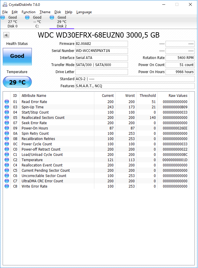

This drive is still well within the warranty period, and has 0 smart-errors. This was something I knew from before,
but I confirmed it by first checking smart_history.log :
2018-04-10 20:41:36  WDC WD30EFRX-68EUZN0  WD-WCC4N5PNXT1N       0             0             0               -1          -1            0             0                  0
and then I connected it to a pc running windows 10, checking with both speedfan and CrystalDiskInfo:
CrystalDiskInfo - seems fine to me?
Link to speedfan results: link: http://www.hddstatus.com/hdrepshowreport.php?ReportCode=11195176&ReportVerification=FDCAF8A2
Also, here's a screenshot of the log. Please ignore the line saying that the seagate-drive was re-installed, that was just me forgetting to unlock the drive before moving it.
