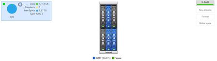

Factory default - data on 3TB drives cannot add 2TB drives
I had some issues (I think Crashplan updates filled up my root mount causing it to no longer boot) that drove me to factory default. I have updated to OS 6.7.1 while I was at it. In the process I cre...
- May 29, 2017
I ended up backing up the data to an external drive and then deleting all volumes. I removed the 3 X 3TB drives and then created a new "data" volume on the 3 X 2TB drives. Once that was created I added the 3 X 3TB drives back in and the volume expanded to include them.
Thanks for your help.
