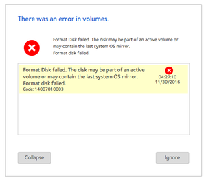

"Format disk failed" – Unable to format new HDD
I just got a new 8TB drive and tried to add it to my ReadyNAS. Unfortunately, I'm getting the following error: "There was an error in volumes. Format Disk failed. The disk may be part of an activ...

Perhaps hook the disk up to your PC and wipe the partition table off it?
- nsneDec 01, 2016Virtuoso
Thanks, mdgm-ntgr. Wiped the GUID using diskpart but it'll be a while before I can test it. My 314 is currently resyncing with the old HDD back in.

I'm running 6.6.0, so this inability to format is probably due to the GUID. I should know by tomorrow morning after the resync.
Well, the ReadyNAS finished resyncing and I added the clean HDD to it. But unfortunately I'm still getting the same error.
Can I reboot the NAS while it's still in "degraded" status and try again?

Almost one month later, following a factory reset and mutiple disk wipes and tests, I'm still getting the same error message for this 8TB HDD.
At my wit's end. The drive passes all tests and functions just fine. It's only my 314 that seems to have an issue with it.
