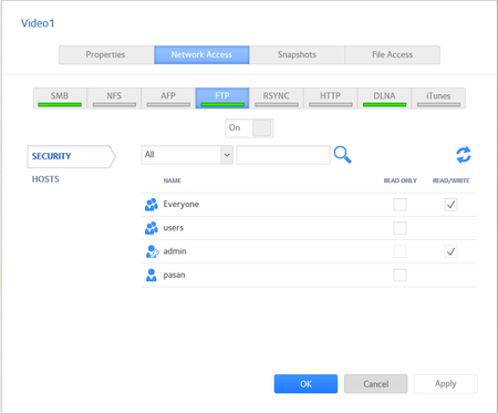

FTP user authenticated access issues - Error code 15002040001
I have enabled FTP access on 2 of my file shares with access permissions Everyone, admin +RW. My understanding is this will allow only authenticated users to access the shares via FTP. How...

Checked the logs, the only clue found is the error log "cannot enable dlna when no volume exists", I am thinking if there are some settings about ReadyDLNA block the operation. Can you try disable ReadyDLNA firstly ? Then try to edit FTP settings.
- pasanMar 05, 2017Aspirant
Ki_Adi_Mundi, after I disabled ReadyDLNA I was able to change the FTP server global settings Authentication to User. But then I was greeted with the same error when I tired to enable ReadyDLNA back again in global settings. However, I was able to go back to the Shares and enable DLNA from the Share settings. It seems there is a bug in the firmware that makes FTP and ReadyDLNA not play together nicely. Hopefully you can fix this in a future firmware update. How do I log a bug report? Thank you.
