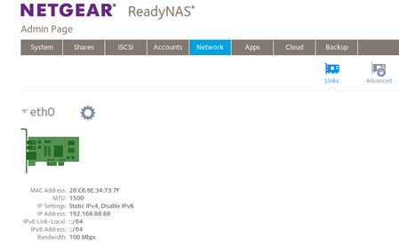

How to set gigabit ethernet?
Hi
The documentation states that my device (ReadyNAS RN10200) must support a speed of one gigabit.
But the real speed is a 100 megabit. At home there is a gigabit router. Tell me, please, how t...

I disabled in the router (Mikrotik) the support of 10/100 megabit network on one of 5 ports (this port is connected to NAS). Only 1000 megabit network remained on this port. And it all worked!
