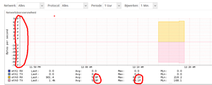

Invalid unit "P" for Dutch (NL) version of 6.9.5 for the network througput graph
In ReadyNAS OS 6.9.5, the unit for the network througput graph in the Performance tab seems incorrect in the Dutch (NL) language version. There is "P", when there should be "k". It seems correct in t...

Retired_Member, not seeing your image in the forum. Looked at the the graph again today. Seems the problem only occurs if I set the period pulldown to include the period before upgrading. So, e.g. 1 week, 1 month. If I set it to 1 day or shorter, the "k" shows up, as expected.
Thinking about the "P" unit, it could be a indicator for Petabyte (https://nl.wikipedia.org/wiki/Veelvouden_van_bytes), since I also see "T" being used sometimes that could be used as the unit for Terabyte. But I seriously doubt my network could ever achieve suchs speeds. I now think that the measurement gap during the upgrade is causing some false data that results in extremely high values in the data througput calculations. Not a big problem, because I seldom look at periods longer than a day.
