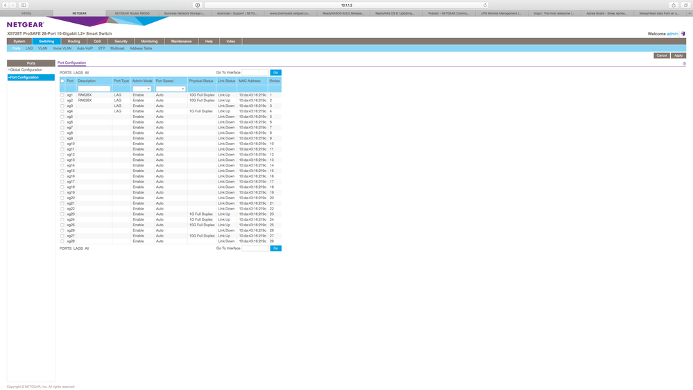

As to the status of the lines, I am trusting the XS switch UI panel not to lie, it says only one line is active, varying from one port to the other over time when I reboot the switch or whatever. This is not the case with the other, more recent unit, the RN626X, where the lines are LAG'd identically and both lines are always shown as active. A screenshot follows (the RN626X is connected on 1&2, the RN516 is connected on 3&4):
Switch port status, XS728T
- Marty_MAug 20, 2017NETGEAR Employee Retired
Hello Tonkinite,
It does appear that both links wont go up at the same time. As per the type hashing for the switch it will depend on the type of switch if it is a layer 2 or layer 3. XS728T switch is only a layer 2 by default it only has layer 2 hashing. We can perform an OS re-install on the RN516 which will reset the network setting of the NAS and see if it will help with the address concern, for guide on how to perform OS re-install please go here and make sure to follow the guide carefully. Also for further isolation, if possible to connect the NAS to just a gigabit switch set the LAG and bonding/teaming then observe the connection.
