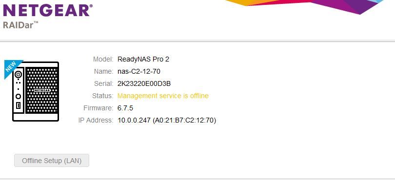

I have a ReadyNAS Pro 2 with 6.7.5
I had lost a hard drive and decided to do a factory reset to remove the RAID array.  After I did that, I have had this issue.
I have taken out the hard drive and reformated it to complete wipe them.  I also used an spare drive just to see if it would install.
When I did this I was told that the drives were dirty and I need to format them again.  I did that via Raidar.
Now all I get is the button for offline set up (in Raidar). I can't pull logs or ssh into the nas anymore (factory reset) That does not work.  Just get a none responsive web page.
I even tried the USB install and that did not seem to do anything.  All I have now is a NAS with blinking blue light.
Any other ideas?
Nothing seems to work.
I have tried OS reinstall, factory reset.  USB recovery.
SSH is not working
I have run out of ideas.
Thanks

    If https://nas-ip-address/fwbroker is responding, then try installing 6.8.0 using that inferface.
    If not, then try a USB recovery with 6.8.0 instead of 6.7.5.

      Sorry I forgot to tell you that the fwbroker is not responding either.
      I have tried the USB with 6.8.0 RC3 but I don't seem to be getting it to apply.
      I am going to try with another USB drive.  I just notice that 6.8.0 just came out. So I downloaded that last night but did not have a change to try it yet.
      Thanks again for the suggestion.  This is the first time it has been this difficult.  I have been using 6.X since it came out on this readynas and have had no real issues.

        To use USB Boot Recovery you would have to use the USB Boot Recovery for RAIDiator-x86 with the OS6 firmware renamed to RAIDiator-x86-something. However USB Boot Recovery can have side effects for legacy x86 devices such as yours.
        The firmware on the flash was corrupt. Your system should now be fixed.
