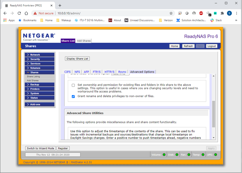

Try resetting the file permissions for the share - clicking the "set ownership..." box here, and clicking apply:
This will happen in the background - there will be a popup in the browser when it finishes.

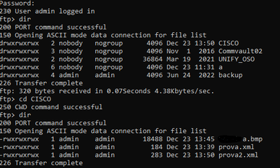

tried the "set ownership" onto the CISCO share , but still didn't make it public
when i HTTP to it it still asks username and pw , and only way is to login as admin
to be sure it did change the permissions i FTPed to it and in fact cisco is now nobody nogroup , but still not public

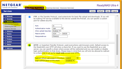

maybe not the correct solution , but found a way to get http access ( for my cisco phones ) without login request
i had to set the share as "read only" in the advanced share settings
then i went into standard file protocols and set redirect to cisco share with no login request
any idea why all this ?
