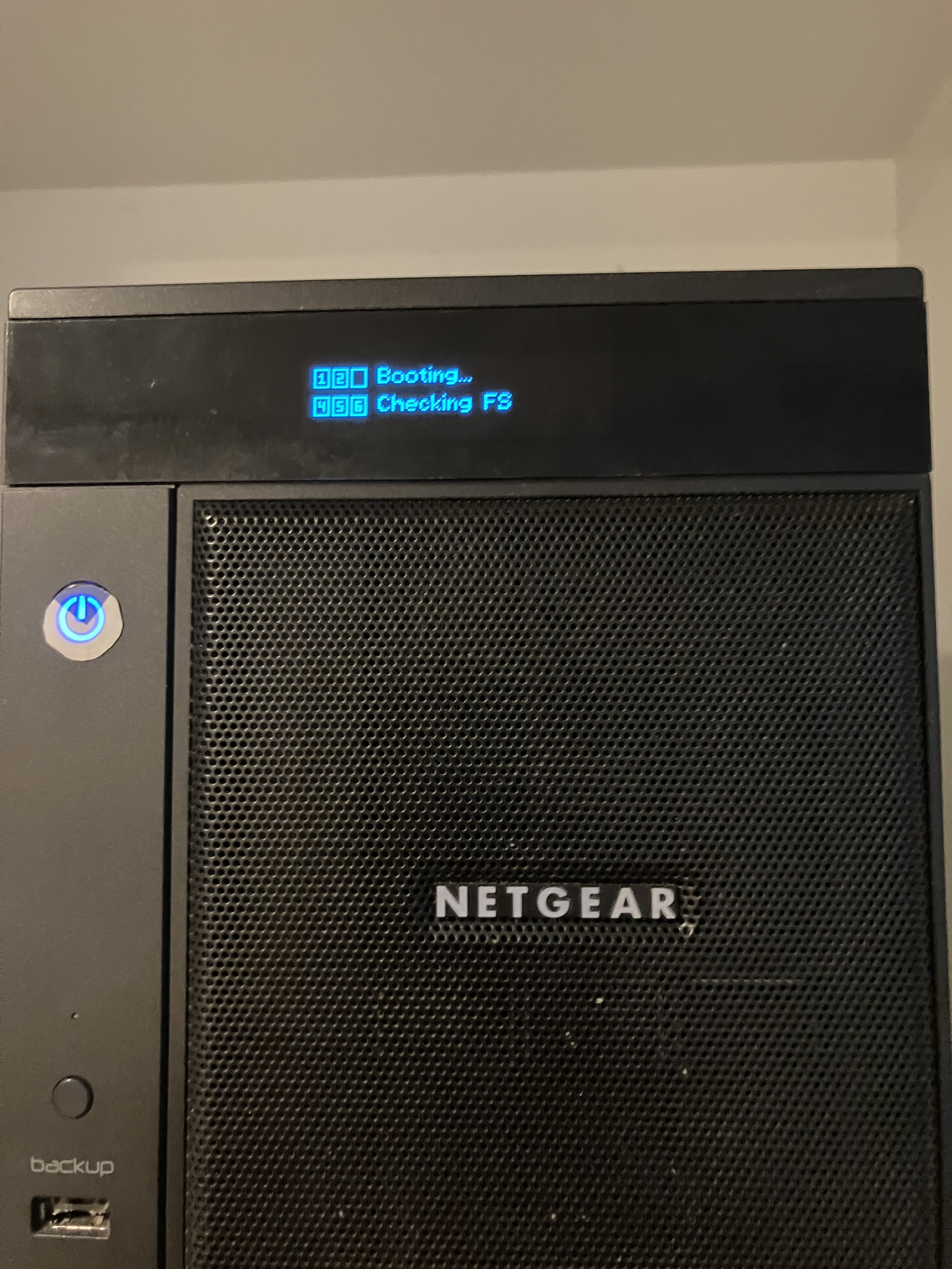

Netgear ReadyNAS Ultra 6 rebooting issue
I'm not an IT person: this will likely show in a way I'm talking about the issue. ;-)
Our ReadyNAS started rebooting every day for the past few weeks.
I thought cleaning the dust would help.
As it wasn't doing anything I switched it off from the cable not using the back ON/OFF.
Worsened the issue.
I tried the reset button at the back using the NORMAL rebooting: became a loop "Checking FS".
I wanted to do an OS reinstall but how do you confirm that choice on the menu: I tried the press and release button at the back but it's not working.
Any video where I checked what I should be doing?

    That is often a sign the power supply is failing, which is a common issue as these units get older.  Did you download the logs, or at least check the system log, to to see if they told you any details as to why it re-booted?
    What do you mean by that?  You just pulled the plug?  That was a REALLY bad idea if it was on at the time, as would be using the switch on the back.  That could be what corrupted your file system.    If it wasn't running, then that likely did nothing.
    While an OS re-install may help, it sounds more like the problem is with the file system, not the OS.  Booting via the rear button menu and choosing read-only may get you booted to the point you can retrieve the logs.
    On an Ulktra6, as with any ReadyNAS with a display, what you are doing via the boot menu is confirmed by the display.
