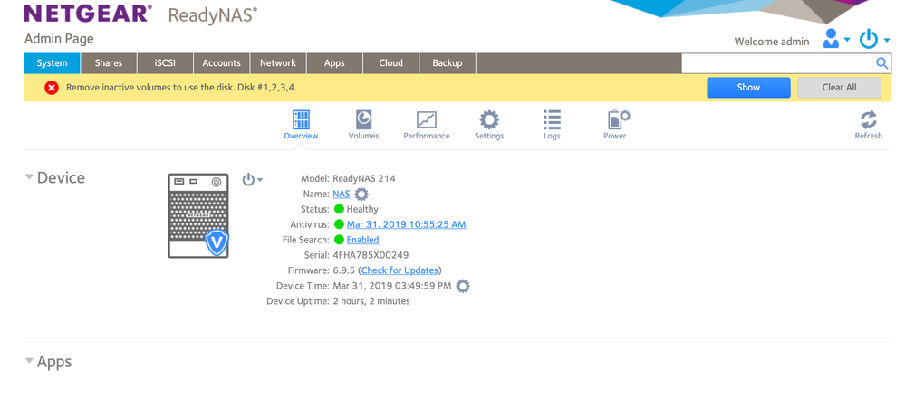

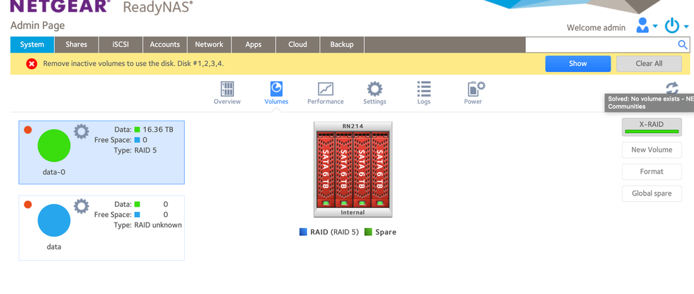

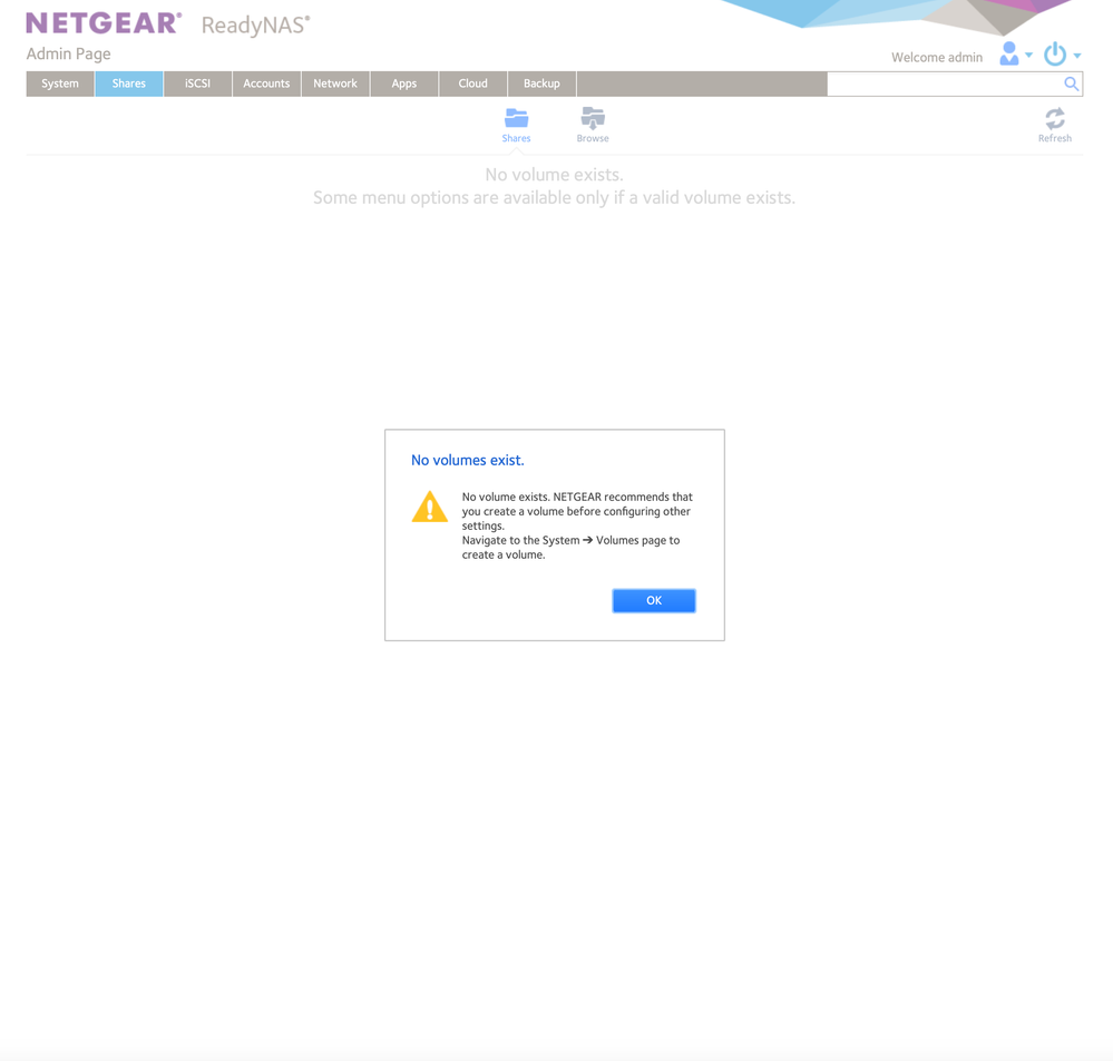

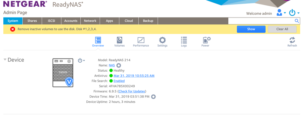

Suddenly, I could't access my data on RN214,
I found the following error message on its web page:
"Volume is inactive or dead"
With knwoing, that it's working on RAID 5 system. now all my data has been gone.
any help?

The reason for the "Remove Inactive Volumes" error is because the data volume cannot mount. In your case, this happens because the data raid is not running at all.
Personalities : [raid0] [raid1] [raid10] [raid6] [raid5] [raid4] md1 : active raid6 sdd2[3] sdc2[2] sdb2[1] sda2[0] 1047424 blocks super 1.2 level 6, 64k chunk, algorithm 2 [4/4] [UUUU] <<<=== Linux swap space raid md0 : active raid1 sda1[5] sdb1[1] sdd1[4] sdc1[2] 4190208 blocks super 1.2 [4/4] [UUUU] <<<=== ReadyNAS OS raid <<<=== Missing data raid (md127)

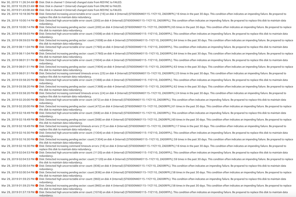

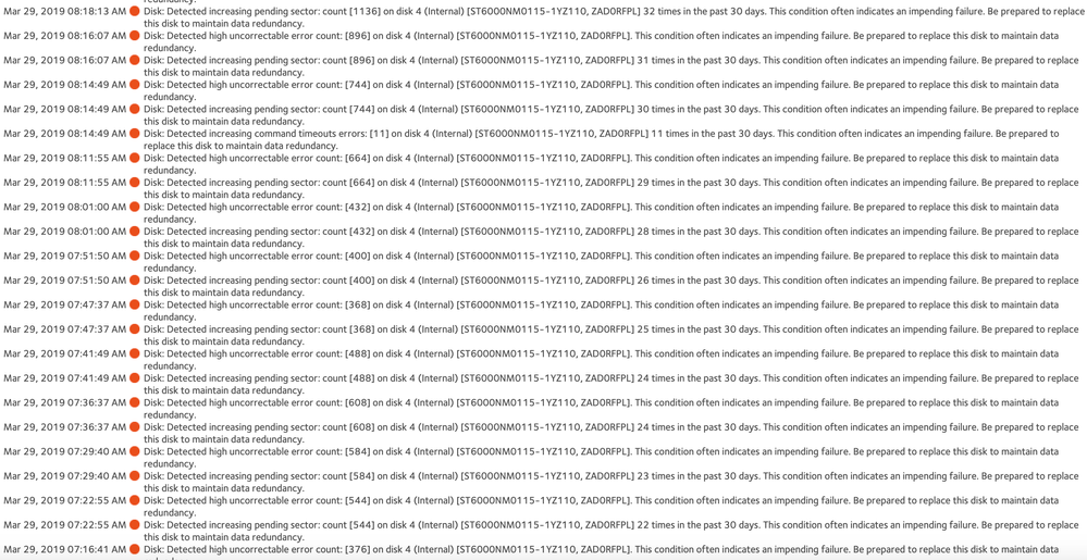

You have two dodgy disks in the NAS and this is the reason. Both those disks were kicked from the raid. This will result in a double disk failure in a raid5, rending the raid "dead". Disk 4 stated to show signs of errors around the 3rd of March and disk 1 started to fail around the 16th of March. Errors on those disks increased as time went on and the disks became worse and worse until this happened in the space of a day.
[19/03/29 16:43:08 PDT] err:disk:LOGMSG_ZFS_DISK_STATUS_CHANGED Disk in channel 4 (Internal) changed state from RESYNC to FAILED. <<<=== Disk 4 fails. The raid is now degraded. [19/03/30 01:29:23 PDT] err:disk:LOGMSG_ZFS_DISK_STATUS_CHANGED Disk in channel 1 (Internal) changed state from ONLINE to FAILED. <<<=== Disk 1 fails. Second disk failure and the raid stops.
The raid has been re-syncing multiple times, likely due to the disks dropping in out of the raid as both are faulty. The additional raid syncs caused extra strain on the already failing disks, accelerating the degradation process.
