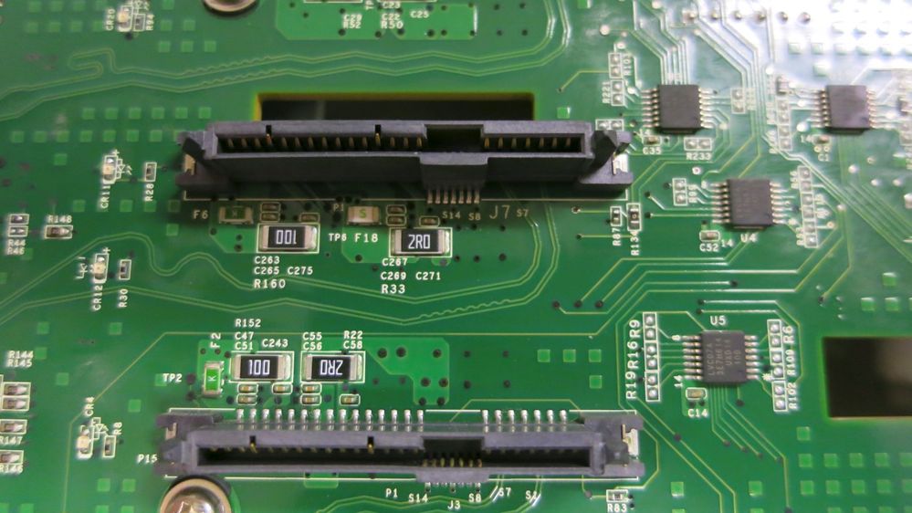

I debugged one RMA RN3220 with this problem. It turned out that the problem might be related to pollutant in the air :(
See attached picture, the black dust has weak conductivity, resulted I2C bus voltage drop on backplane. While it does not affect backplane I2C bus operation, it does affect I2C bus buffer for PSU PMBus which is sensitive to voltage level. I cleaned up backplane using dust blower, the system was back to normal.
