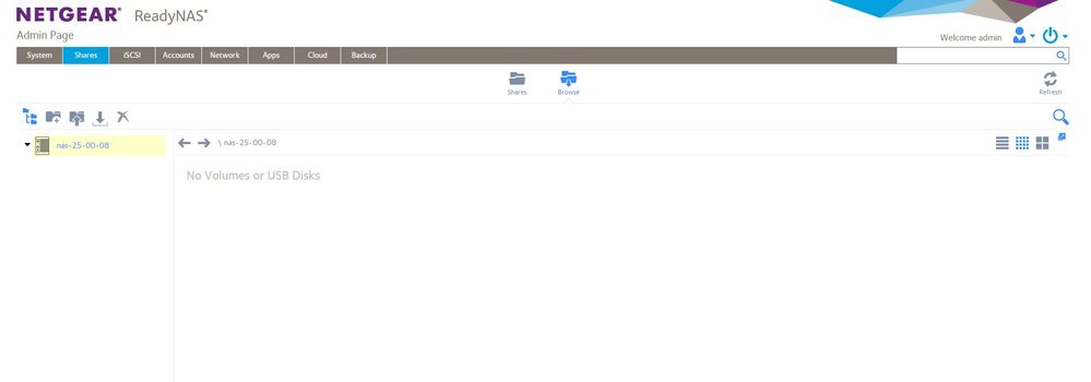

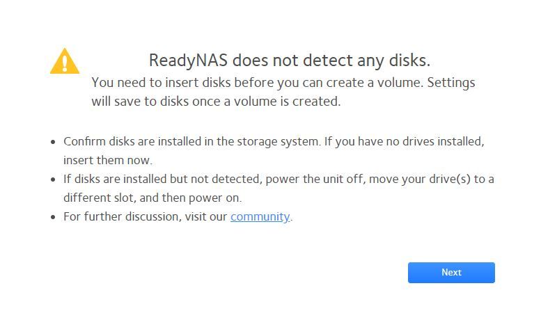

Hey guys,
I recently did a firmware upgrade on a ReadyNAS 2100v2 from 4.2 to 6.10.8. When I connect to the device through my browser it now tells me that it's not detecting any disks.
These are the same 4x2TB WD Red Pro NAS HDD's that were in there before and working on OS 4.2. Now they're undetectable.
I've moved the drives to different slots like suggested.
I plugged the drives into a PC and deleted all previous volumes. The drives all show up as "Unallocated" now.
I plugged the drives in 1 or 2 at a time in different slots.
I did a "Perform Factory Default" from the Admin page.
Nothing worked and the disks still aren't recognized.
On the front panel of the device, only Power and LAN LED lights up. All disk LEDs are off.
Is there something I'm supposed to do first, or did this update break something?
