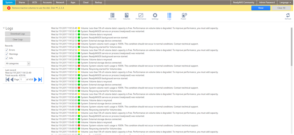

sectoid wrote:I tried using SSH to create a dmesg log myself but I couldn't because I got the error "dmesg: write failed: No space left on device"!! My HDDs have plenty of space but of course it's referring to the internal space of the NAS.
It's not referring to the Flash card but to the OS volume created on the HDDs.
You see, there are three volumes created on the HDDs, the OS, the swap and the data (multiple pieces for data in certain cases).
If it tells you that there is no space left when trying to extract the logs, that would mean that the OS volume is full. Sometimes, this prevents the data volume from being mounted.
Can you check with df -h if md0 is full?
If it is, follow these steps: https://community.netgear.com/t5/Using-your-ReadyNAS/RN314-FW-6-7-1-root-partition-full-how-to-fix/m-p/1284659/highlight/true#M130056

The NAS is generating a lot of logs, I'm attaching an screenshot of it.
I tried using SSH to create a dmesg log myself but I couldn't because I got the error "dmesg: write failed: No space left on device"!! My HDDs have plenty of space but of course it's referring to the internal space of the NAS. How could this happen? I have only one app in use, Transmission, but my use of it is very light, occasional. I also use the amazon drive synchronization.
