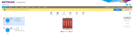

RAID 6 inaccessible after hdd upgrade
 Hello,     I had 4 seagate 3TB drives on my ReadyNAS 104 firmware 6.7.4, using RAID 6. One of them went bad, so I exchanged it for a seagate 4TB drive. After a few days resyncing, it finished without...

The NAS is generating a lot of logs, I'm attaching an screenshot of it.
I tried using SSH to create a dmesg log myself but I couldn't because I got the error "dmesg: write failed: No space left on device"!! My HDDs have plenty of space but of course it's referring to the internal space of the NAS. How could this happen? I have only one app in use, Transmission, but my use of it is very light, occasional. I also use the amazon drive synchronization.
So here's the output of dmesg which I got by hand using SSH:
https://www.dropbox.com/s/6r0swgcexehunok/readynas104-dmesg.log?dl=0
Thank you very much for your help!
