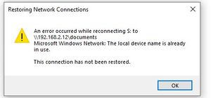

ReadyNAS 102 randomly dropping mapped drive(s) on Windows 10
I am having an issue where my mapped drives on my ReadyNAS drop off intermittently and then become available again. I am at the most current firmware version (6.10.10). Following is the error I rece...

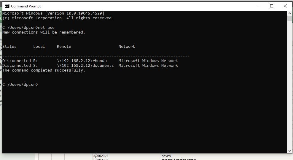

I did not mention it but one of my first troubleshooting efforts was to replace the CAT V cable for the NAS and plug it into a different port on the switch. It did not make a difference. Not sure what you mean by "green" switch. It is a Netgear model GS316. It is an unmanaged switch - there is not an admin page to make any adjustments to settings.
Following is the screen print of the status using NET USE command after the connection to the drive is lost. I understand what you are saying about the ping command not being a complete diagnostic tool for checking connectivity. It is just weird that it will disconnect while I am actively using the drive and then magically reconnect (or I can issue the Net use command to attempt to force it to reconnect). I have rebooted it (after updating firmware) and it seems to restart without any issues. If I lose power in the house it powers back up OK after the power is restored.(yes it is on a surge suppressor). Nothing in the logs indicates any types of errors.
