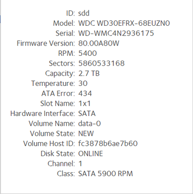

    What are the smart stats on the disks?  Disk 1 looks like it might be failing.

      Disk 1 looks like this:
      The other disks have error rates of Disk 2 = 225, Disk 3 = 197, Disk 4 = 271.
