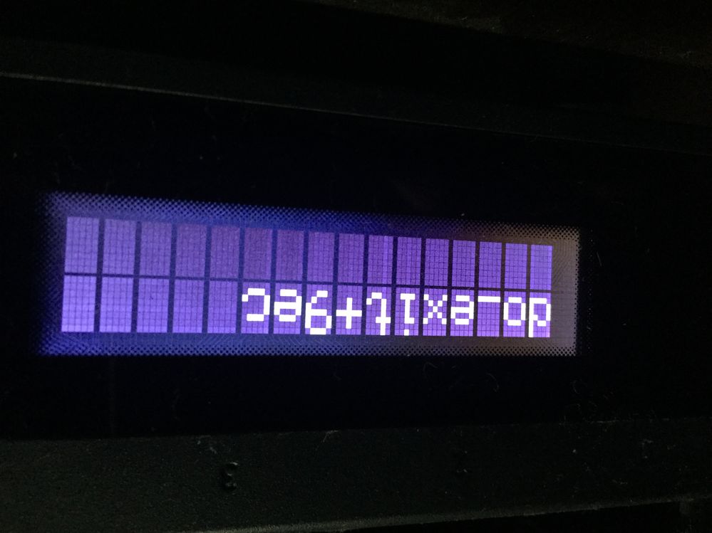

ReadyNAS 204 Will not shut down fully, shows do_exit+9ec
When trying to shutdown my ReadyNAS 204 it hangs with an error of do_exit+9ec on display. The only way to recover is to disconnect the AC power cord and reconnect. I have the most current version ...

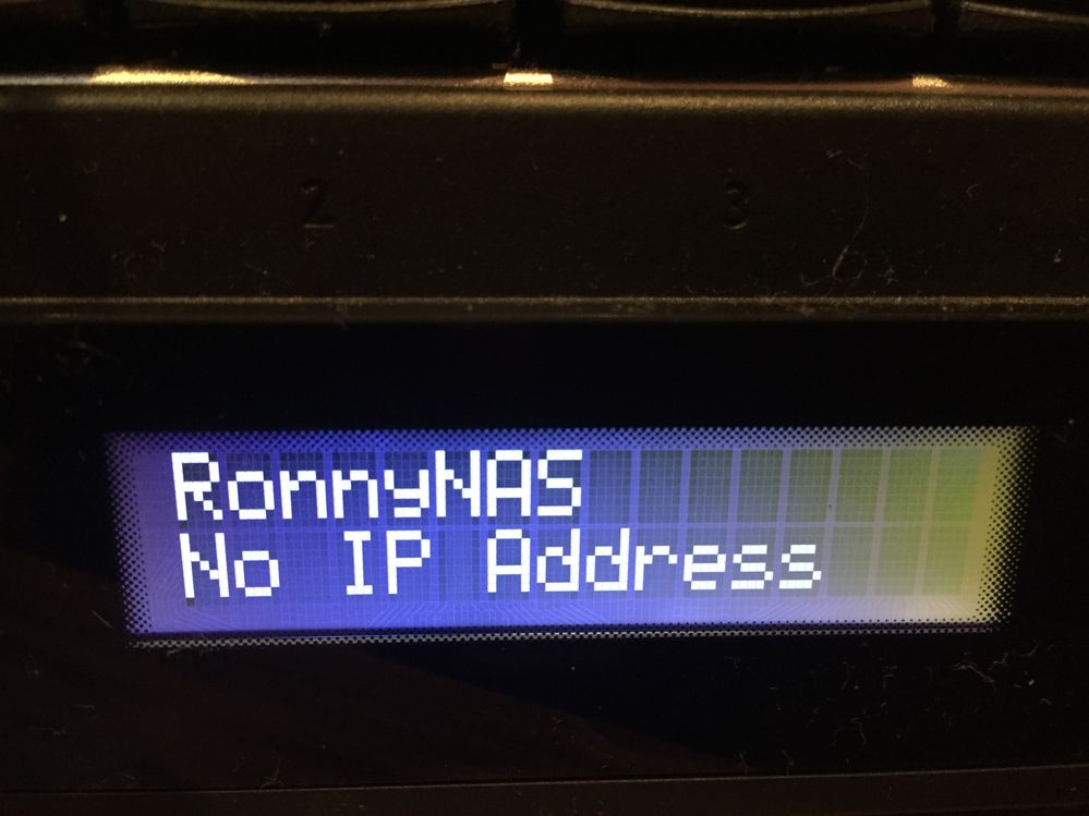

In my case, the system was unplugged for serveral days, so it was cold, still have the issue, no IP address.

4. If boot finishes, you press power button two or three times depends on if LCD is on, does it initiate power off sequence, and eventually display do_exit+9ec message on LCD with system fully shutdown but fails to turn off power?

1. Did you try both upper and lower Ethernet port? Did both ports fail to get an IP address?
Yes, both ports and nothing. Even tried to boot up with each one, after the system is cold, and nothing, both ports fails to get IP address.

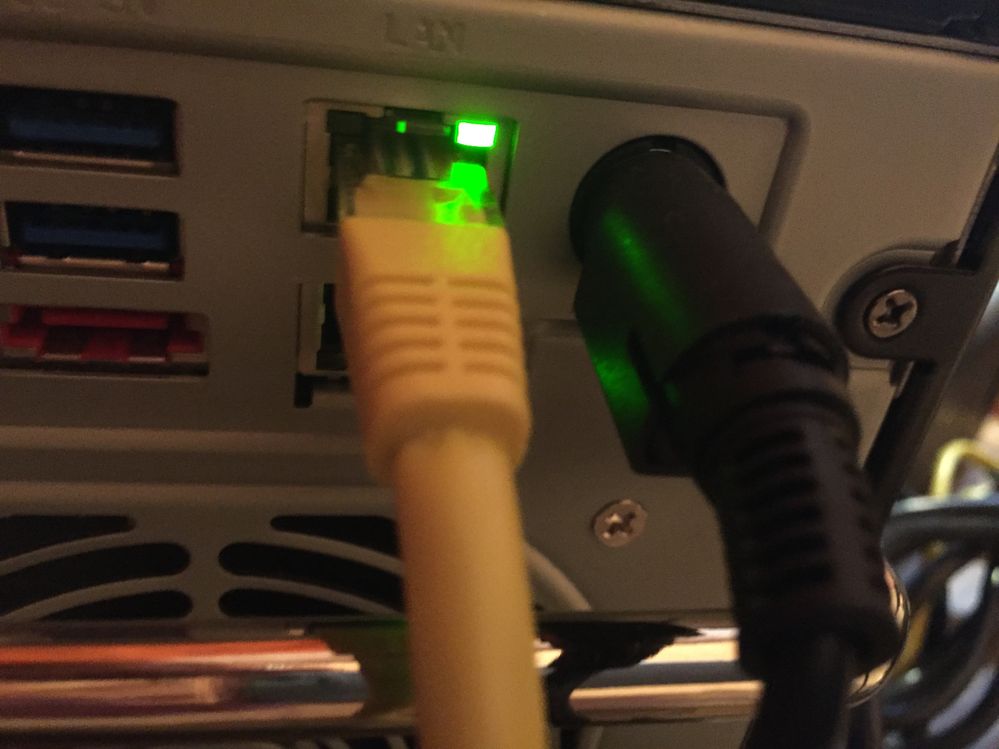

2. When it fails to get an IP address, did RJ45 LED on Ethernet port come on? Or no any Ethernet LED at all?
Yes, both ports shows a solid green light only, no other light or color is displayed. See pics. Both Ethernet shows this solid green light wheather the cable is plugged or not.
Yes, what you described is exactly what happens....

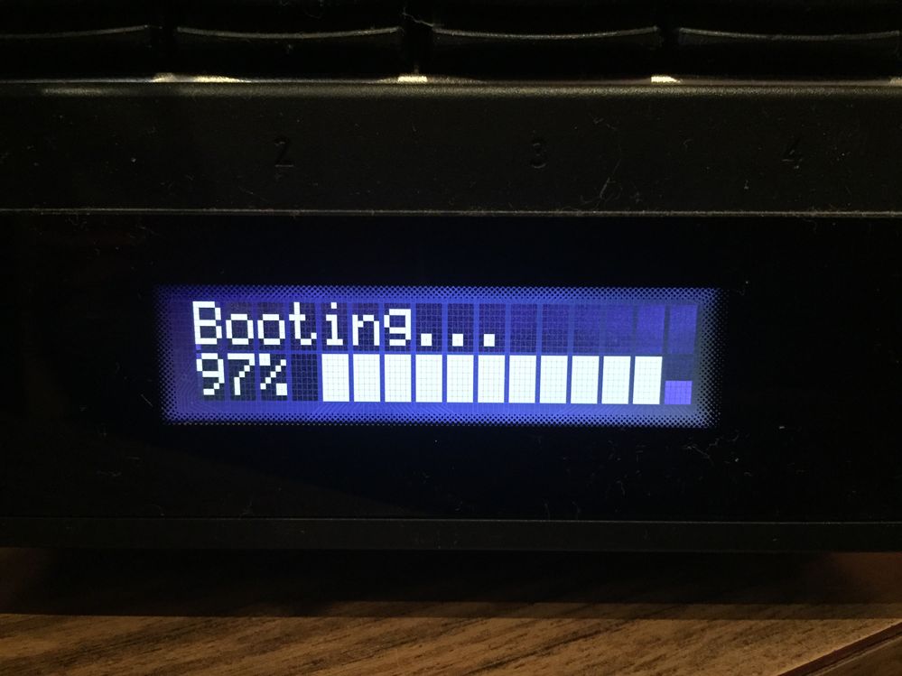

5. Anything else you felt abnormal before the system ran into problem? I don't know if it is abnormal or not, really didn't pay attention to it before the problem, but the system boots up quite fast until it gets to 95%, the it takes longer time to finish, but it does finish OK. I reinstalled the OS from the boot menu, didn't fix anything. The fan sounds normal, the system temperature as I touch it, seems normal.
