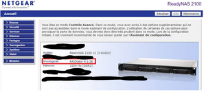

ReadyNas 2100 v2 upgrading Firmware
You can guide me if this ReadyNAS can update the firmware to the OS6 version, so that it can be synchronized with OneDrive business or if I need to acquire a new NAS.
