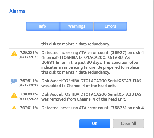

RN214 I've had for a number of years had its first disk issues: lots of ATA errors for disk 4 and "degraded" status for the RAID-5 volume. I bought two new drives from Newegg (Toshiba DT01ACA200, same model as the original one) and performed a hot swap, but the RN214 never acknowledges that the new drive is there or starts to resync the data... in the on-screen diagram, it shows only three drives
This is the same whether I use either of the new drives.
If I put the original drive back in place, it shows up, and the RN214 logs start showing the ATA errors again.
This leads me to suspect that there's nothing wrong with the drive slot. The alarms dialog shows the old drive being removed and reinserted, but nothing about either of the new drives.
Any suggestions will be greatly appreciated!

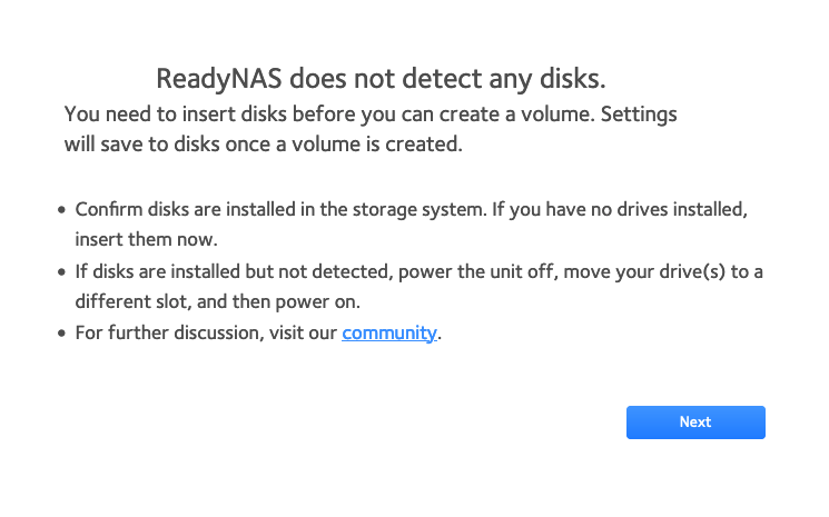

        I'm unable to find my SATA cable (it's a moving box somewhere) but both drives fail the "try it alone in slot 1" test. After the RN214 boots and gets on the network, the admin UI shows "no drives detected". I'm going to return both drives to NewEgg.
