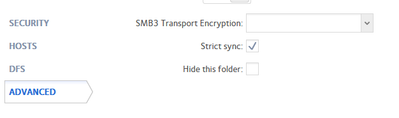

If you go into the share settings -> network access -> SMB -> advanced, you'll see a "Strict Sync" setting. You could try turning that on, and see if that resolves the issue. (Performance might slow down though).

Unfortunately, "Strict Sync" is already enabled for this particular share.
You could try reversing the setting.
