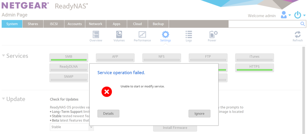

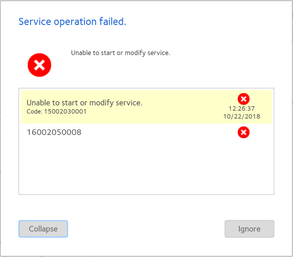

On the flipside, since the previous remedy was employed, I've been unable to successfully interact with the 'System> Settings> Services' items; as a result, it's been a gruling process to move items, given that I no longer have access to SMB. There are no errors or warnings in the logs, but the consistent [detailed] response to my immediate attempts is: "Unable to start or modify service. Code 15002030001".
I haven't made a new case for this yet (nor am I sure if that would even be the appropriate course of action), but for now I'm focusing on offloading whatever I [safely] can. At this stage, I have the same error when attempting to enable Antivirus and SSH (both of which are off as a result).
I've casually sought out solutions, but haven't found anything concrete yet. If anyone has any suggestions or ideas, I'm open to hearing them. :smileyhappy:
