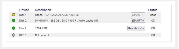

I connected the drive as a USB volume to the NAS and had the NAS reformat it as EXT3. So in theory this should be a blank drive now.  But when I put it into the NAS, nothing happens. It does not automatically reformat and re-mirror the drive.  It also does not recognize the brand of drive any more.  (See below).

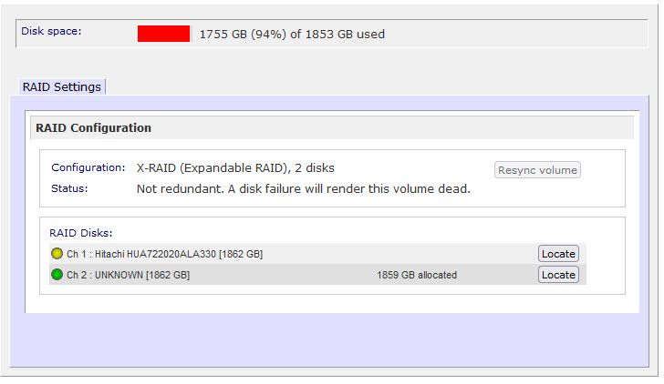

      Another thing I noticed is that the NAS claims that drive 1 is dead (see screen cap.) So I pulled it and installed in my SATA dock and checked its SMART data with Crystal disk info. It told me the drive was healthy so I was guessing maybe the nas was referring to the RAID set being dead?
      The frustrating thing is that the "resync"  is not available on the volumes screen. Is it possible that the NAS is not trying to reformat and sync drive 2 because it thinks drive 1 has failed?

        I think it's quite likely that the declaration of drive 1 being dead is the issue.  I had a similar issue on an older NAS where drives were declared dead.  It was due to different spin-up times.  Does drive 1 come up as dead when you boot with just it installed?  That would be quite unusual if you still actually have access to the NAS and its contents.
        The only thing I can suggest is booting with just drive 1 until it doesn't come up as dead, then hot inserting drive 2.
