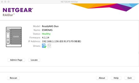

ReadyNAS Duo RND2110 v2 "System is starting up..." blue light blinking
I have a ReadyNAS Duo RND2110 v2 with a single Seagate Barracuda 1TB drive in it. When I start the NAS, RAIDar briefly shows: Model: ReadyNAS Duo Name: ESMENAS Status: Healthy Firmware: 4.1.14...
