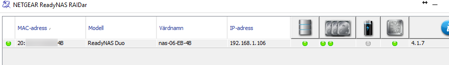

ReadyNAS Duo v2 Factory Reset but can not login
I have done a factory reset, but I can not login.
I tried admin+password and a lot of other combinations.
What can I do ?
  • The Duo v2 runs 5.3.x firmware, the Duo v1 runs 4.1.x firmware.
    You seem to think you have a Duo v2, but the RAIDar screenshot above shows you are running 4.1.7 firmware.
    So you in fact have a Duo v1. The labels are confusing, many people make this mistake.
    The default admin password for the Duo v1 is netgear1.  So try that.

      I dont know what volumes that are created, I only see this in Radiator.
      I can not login at 192.168.1.106

  • StephenB's avatar
    StephenB
    • pcpro1's avatar
      pcpro1
      Thank you so much it was netgear1 as password, I had no idea.
