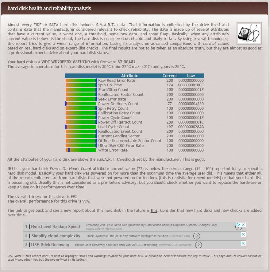

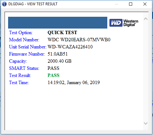

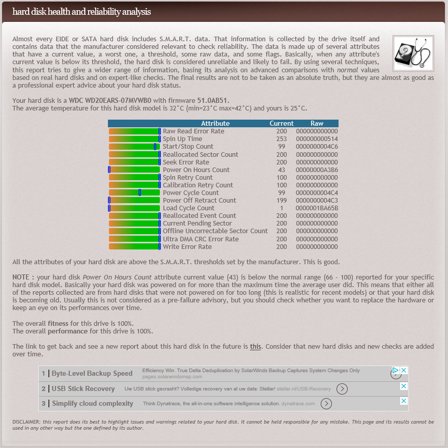

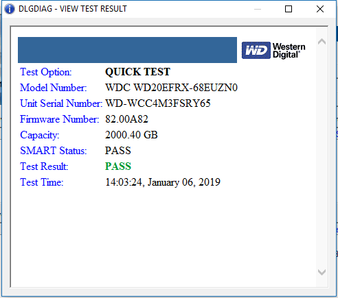

      I ran a quick check on disks 1, 2 and 4. And they all look ok.
      SMART
      Lifeguard
      What could have caused the volume to go offline?
        I agree the disks look ok.
        It is possible that the power failure resulted in lost writes - that can damage the file system even when the disks are good.
