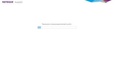

Problem: connects to the admin page for only a few seconds, then the message: "Connecting to the ReadyNAS Admin Page"

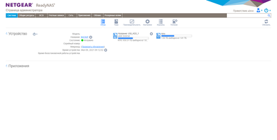

Step 1. Login
Step 2. Admin page
After 3-5 second message: "Connecting to the ReadyNAS Admin Page"
And so in a circle...
