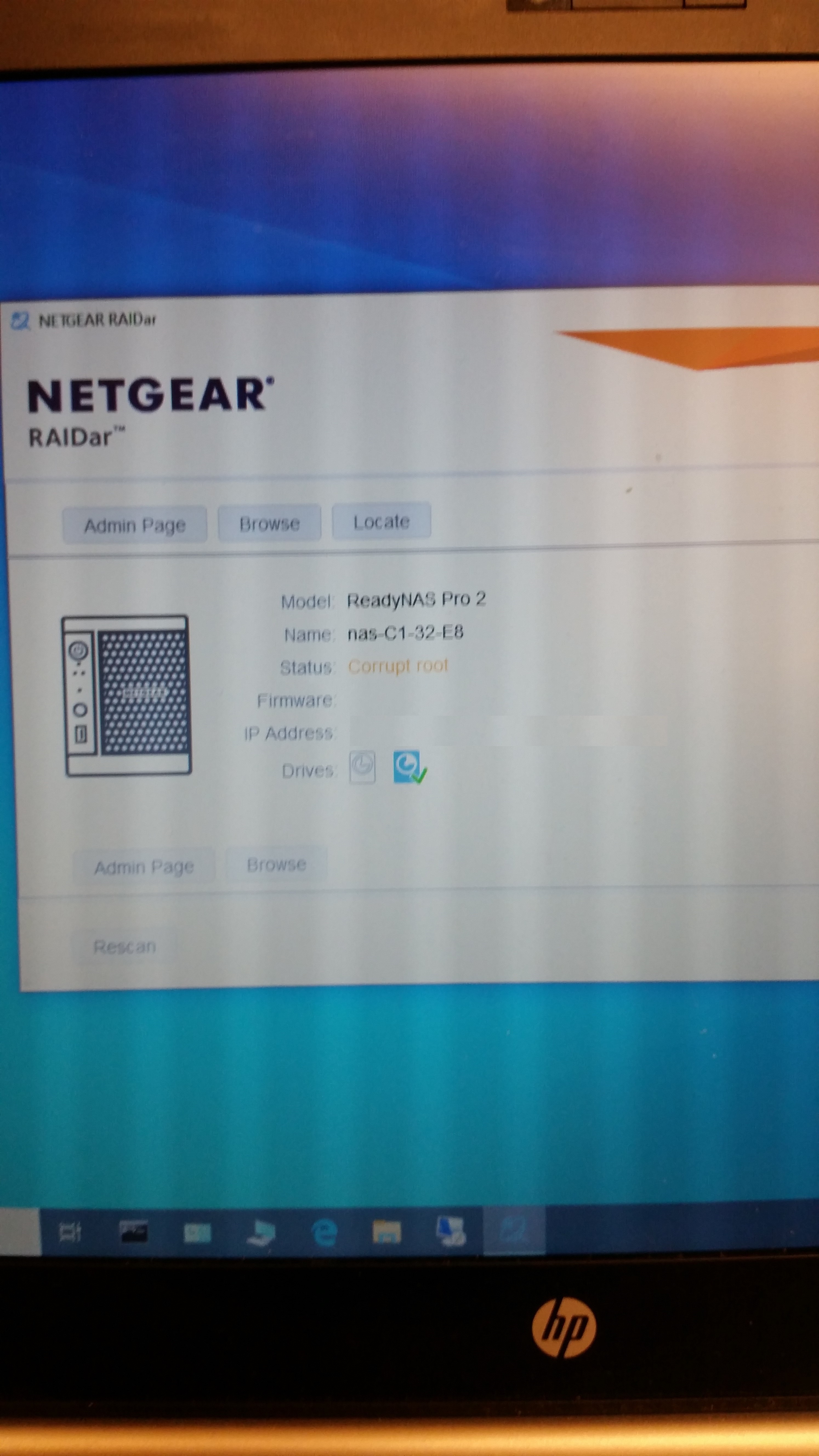

I have readynas pro 2 , and the status corrupt root .
I don't want to reset the device because I have data i don't want to lose .
Also I try access to the device from the browser by using ip address , but it's giving me error can't find the device .
In attachment photo from the screen .
And in the photo you can see the first Hard Disk disabled and the second Hard Disk enabled I don't why happen this problem ?

    You could try powering down the NAS, and booting up with only disk 2 in place.  If that works, then immediately back up your data.  Don't write more data to the NAS.

        I also I take off the Hard disk from the readynas pro 2 and I insert in stata adapter .
        And I connect the stata adapter to my laptop directly , the hard disk not appear in disk management i cannot see the hard disk
  • also the hard disk number two not working when I connected to my laptop by using sata adapter its not appear in device manager , so I lose all the data .

      Are you running the Microsoft Disk Manager?  The disk format won't be recognized by windows, but they should show up in the disk manager.
      You could also try installing the vendor disk diagnostic, and see if it can find the drives.  Install Lifeguard for Western Digital; Seatools for Seagate.

        Yes windows 10 .
        I installed Seatools for the hard disk but cannot see the hard disk .
        I need solution for the problem .
