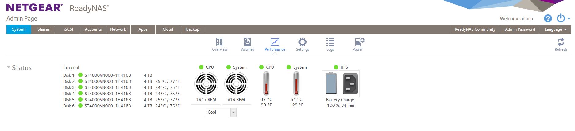

I am running firmware version 6.9.3 on a old ReadyNAS Pro 6.  Lately I have noticed that the system temperature is running higher than normal.  I have noticed temperatures up to 68C.  Hard drives and CPU temperature appear to be normal.  Room temperature is probably between 65 and 85 degrees F depending on outside weather conditions.
I took a screen shot of the temperature values after the unit had been running for 30 minutes and it was already 62C.  See attached.
The System fan speed does not appear to adjust enough to keep the system running cooler, even though I changed the setting from balanced to cool.  Fan speed changes very little if at all.
How hot should I allow the system to run before it will cause damage to the unit?
Is there anything I should do to try and get the unit to run cooler?
Thanks
    My pro-6 (running 4.2.x) is showing 57C system temps at the moment, and that is a typical value in a 4.2.x system.  Perhaps other folks running OS 6 on their pro-6 or ultra-6 pro some input on their temps.  The temp sensors are different on the 2 and 4 bay units (and also ultra 6).
    I'm not sure how much to trust that particular reading.  How hot is the air being vented from the back?  Any signs that the system board is actually hot?
    Also, any sign that the chassis fan isn't working properly?

      My Ultra 6 Plus, which identifies itself as a Pro 6 Business Edition, runs 6.9.3 and has upgraded CPU and RAM. It is currently resyncing during vertical and horizontal expansions. System temperature is 59º C, CPU 41º C, and drives 33-38º C. These temperatures are typical during the summer in a bedroom-sized room kept in the upper 60s nights to lower 70s days (ºF) with a whole house evaporative cooler.
  • Thanks for everyones input.
    As suggested I tried turning off Bit Rot Protection for each share on the NAS.
    After letting it run overnight it cooled down to a new record low temperature with a system temperature of 54C.
    Please note that this is with it set on the Cool setting.  Not sure what happens at the Balanced or Quiet setting.
    See new attached screen capture.
    It appears that both fans are working properly.  I also set the hard drives to go to sleep after 15 minutes.
    I think my next step is to do a real good cleaning of each fan and surrounding internal areas.
    I am much more comfortable with the lower temperatures now.  I just hope that turning off Bit Rot Protection does not cause other problems in the future.

        I am not sure what is going on here.  I changed nothing last night and the NAS system temperature was back up to 60C this morning.  The system fan speed was reported as 753 RPM which is lower than normal.  It appears that the NAS simply wants to run hot by lowering the system fan speed just to keep warm.
        I already have disk spin down enabled after 15 minutes.  Disk temperature is around 85F.
        I grabbed a screen shot showing how much work the NAS was doing for 24 hours.  It was almost nothing but the temeratures slowly increased overnight.
        Is there something in the operating system software that controls the fan speed relative to temperature?
        If there is then it does not appear to be working as I would expect it to.
