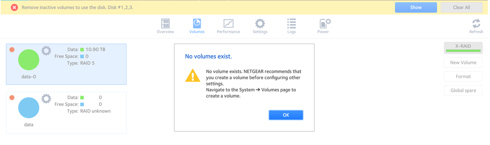

I booted my three 6tb cloned drives in read-only mode and I see the following. Am I supposed to do something else or does this indicate bad news?
- StephenBMar 20, 2023Guru - Experienced User
Not good news, but potentially fixable. You definitely don't want to create a new volume.
